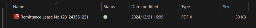

I wanted to make just a change to the code by creating a variable that 'holds' the date in my remittance form, rather than using your proposed code .......' Format(WS2.Range("J14"), "yyyymmdd") , which by the way works 100% Ok.
Is only that i thought i could save the date in a variable called "invoicedate" ( see below), but the PDF writer saves the file with a weird name like below:
( in other words instead of 20241221 as today's date , it saves it as an unrecognizable number "2435612221
How can i get the invoicedate variable to hold the number the correct way i.e. 20241221 ?
Your bad as a "y" char is missing within the date format !​
