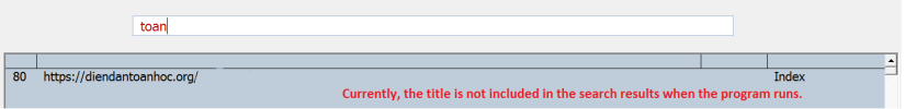

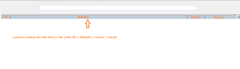

I have built a data table and a data search function for Excel using a VBA ListBox. Everything works perfectly, but now I want to add a title to the search results. Does anyone know how to do this?
Currently, the title is not included in the search results when the program runs.

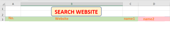

This is my source data table, I would greatly appreciate any assistance
You can only use the built-in column headers if you output the data to a range somewhere and then use the rowsource property of the listbox, assigning the data range address (i.e. excluding the header row). The listbox will automatically use the row above for the headers.
Thank you all for taking the time for me. The issue has been resolved. I used the function to copy all the titles from the source data as search titles. This method may not be optimal, but at least it helps me solve the problem for now.
