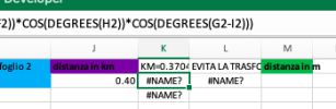

I seem to have understood that at the coordinates I have to replace the period with the comma. Then the formulas in columns "k", "l" and cell O3 appear as if there were no "=" before the formula or I find "#NOME?"

Try this way:
#1 Select cell K2
#2 Select end of formula in cell K2
#3 Press <ENT>
# Cell K2 should look like above.

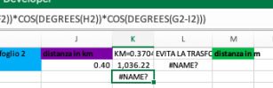

claudia80
One more try (for me above works) ... hmm?
You expect to get numbers to those cells (K2:L3)
... then make sure that those cells are Formatted as General or Number ( in Your file those are Texts )
Sometimes it helps it add in front of formula ' >> press <ENT> >> take away that ' >> press <ENT>

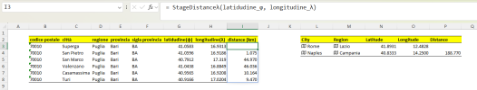

I didn't post this first time round for the fear of creating more confusion. It is based upon the layout of sheet 2 in which way-points are used to define a multi-stage route.
  • distances.xlsx
