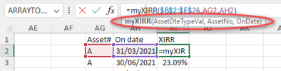

First, the attached is unfinished (I only re-read your last message just before posting this and realised you were wanting this for asset/asset category combination and the attached only looks at Asset#). I will have a go later.
The finished formula is in column AI
It may be of interest to you to see a little on how it was derived; see the yellow cells in columns N:AD.
The formula expects to see a Valuation transaction type on the On Date.
I don't know what the Commitment transaction type is and have excluded them because your manual calculations excluded them.
Note that the formula has hints:
