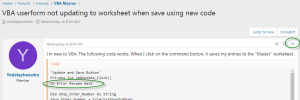

VBA userform not updating to worksheet when save using new code
I'm new to VBA. The following code works. When I click on the command button, it saves my entries to the "Master" worksheet.
'Update and Save Button'
Private Sub cmbUpdate_Click()
On Error Resume Next
Dim Shop_Order_Number As String
Shop_Order_Number = Trim(txtShopOrdNum)
lastrow = Worksheets("Master").Cells(Rows.Count, 1).End(xlUp).Row
For i = 2 To lastrow
'CDbl(txtText.Value) is needed for currency, does not work for percent
If Worksheets("Master").Cells(i, 4).Value = Shop_Order_Number Then
Worksheets("Master").Cells(i, 1).Value = txtPrefix
Worksheets("Master").Cells(i, 2).Value = cboStatus
Worksheets("Master").Cells(i, 3).Value = txtSuffix
Worksheets("Master").Cells(i, 4).Value = txtShopOrdNum
Worksheets("Master").Cells(i, 5).Value = txtEmailSubLine
Worksheets("Master").Cells(i, 6).Value = txtNotes
Worksheets("Master").Cells(i, 7).Value = cboStage
Worksheets("Master").Cells(i, 8).Value = CDate(Me.txtStartDate.Value)
Worksheets("Master").Cells(i, 9).Value = CDate(Me.txtStageDue.Value)
Worksheets("Master").Cells(i, 10).Value = CDate(Me.txtEndDate.Value)
Worksheets("Master").Cells(i, 11).Value = txtDays
Worksheets("Master").Cells(i, 12).Value = cboProcess
Worksheets("Master").Cells(i, 13).Value = txtPropNum
Worksheets("Master").Cells(i, 14).Value = cboSalesPer
Worksheets("Master").Cells(i, 15).Value = txtPrimSalesTerr
Worksheets("Master").Cells(i, 16).Value = CDate(Me.txtPropDate.Value)
Worksheets("Master").Cells(i, 17).Value = txtLT
Worksheets("Master").Cells(i, 18).Value = CDate(Me.txtPromDate.Value)
Worksheets("Master").Cells(i, 19).Value = CDate(Me.txtExpDate.Value)
Worksheets("Master").Cells(i, 20).Value = CDbl(Me.txtCost.Value)
'redacted columns 21-102'
Next
ThisWorkbook.Save
MsgBox ("Your work is saved")

Success! I've attached an updated sample file.
First - I appreciate the warning re: On Error Resume Next. I'm still learning and appreciate your insight. I will be more careful.
Second - Makes sense to use the table reference
Third - RE: [LISTS!C2:C6] the named range is tblSrvGrp. Would it be written like this instead? cboSrvGrp.List = [tblSrvGrp].Value
Fourth - The code you provide is awesome. It works great and I'm working on the other command button codes to streamline them as well.
Date challenge: The following code works like a charm!
I'd add a function like:
Function GetDate(inputText As String) As Variant
   If Len(inputText) <> 0 Then
      GetDate = CDate(inputText)
End Function
then use GetDate in place of CDate.
It seems unlikely to me that you should be looping here, unless you really do have multiple lines for the same order number and need to update them all?
However, I have 22 dates and attempted to edit the code accordingly...
Function GetDate(Dates As String) As Variant
    Dates(7) = txtStartDate 'Compile error: expected array on "Dates(7)"
    Dates(8) = txtStageDue
    Dates(9) = txtEndDate
    Dates(15) = txtPropDate
    Dates(17) = txtPromDate
    Dates(18) = txtExpDate
    Dates(22) = txtPODate
    Dates(23) = txtPORecDate
    Dates(62) = txtConPO
    Dates(63) = txtE10
    Dates(64) = txtFinance
    Dates(65) = txtReqPM
    Dates(66) = txtPMAssign
    Dates(67) = txtSOATeam
    Dates(68) = txtApproved
    Dates(69) = txtSOACust
    Dates(70) = txtSOAE10
    Dates(71) = txtAR
    Dates(72) = txtCurPromDate
    Dates(73) = cboRecRev
    Dates(75) = txtShipped
    Dates(101) = txtTimestamp
If Len(Dates) <> 0 Then
      GetDate = CDate(Dates)
End Function

The codeline has no sense on an array so the crash … What is it supposed to do ?​
And again remove the useless On Error codeline !​
@Marc L My newness to VBA is blaringly obvious. I assumed 'inputText' was a placeholder. I renamed it txtStartDate and assumed I needed to do that for all dates. Long story short, I found my error and figure it out that this code works on ALL dates as is.
The On Error Resume Next was in the code Debasser provided above. I assumed it was ok since he included it. I've since removed it and here is the code without it and it works fine for ALL dates.
End Function
@Debaser - Once I understood this code works on ALL dates. I did a happy dance. I appreciate your help!
Thank you all for your insight!
Yes. The original ‘On Error Resume Next’ was mine. But, I was referring to Debasser’s post on Thursday at 3:52 AM.

You are making a beginner mistake by assuming that because Debaser used On Error Resume Next in his small subroutine, that it was OK for you to use as the first line of code in your much larger subroutine. The way he used it was in a limited way for a specific purpose. The way you used it was not. Globally suppressing runtime errors is almost always a bad thing. Putting On Error Resume Next as the first line of code in a complex subroutine cripples your abilty to know what is happening when something goes wrong.
