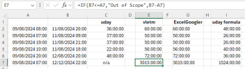

WOW! Nice, I like this much better but I would add to the condition just-in-case the difference is within the same day.
=IF(AND(INT(B2-A2)<=0, HOUR(B2-A2)<=0, MINUTE(B2-A2)<=0, SECOND(B2-A2)<=0),"Out of scope", B2-A2)

Below: B2 & B2 are same as well as C2 & C3.
This works always, if values are valid date & time.
If C2 < B2 then it works same way with C3 < B2 ... negative.
... or there always can get absolute value and add "-" in front of result.
