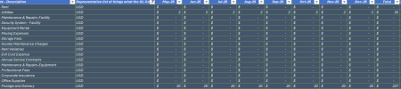

this is what i have in each sheet:

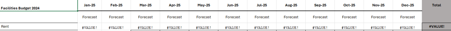

And i want a result in summary sheet:
I used the formula: =SUMPRODUCT(SUMIFS(INDIRECT("'"&Sheets&"'!$C$4:$N$500"),INDIRECT("'"&Sheets&"'!$a$4:$a$500"),$B4,INDIRECT("'"&Sheets&"'!$b$4:$b$500"),"USD",INDIRECT("'"&Sheets&"'!$C$3:$N$3"),MONTH(C$2)))
where sheets refer to named range
