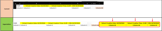

Hi, I am looking for help in Power query extraction, where in Row 1 the CSV file has specific values in the cells B1 (Date), C1 (Time) & D1 (Date) associated with the file. Proper dataset starts from Row 2 which has 64 columns. I would require the cells B1, C1 & D1 to retrieve as additional 3 columns to the dataset. Post which we will promote the row 2 as headers of the dataset and use these 3 fields to the dataset. We have attached 2 files as below:

Hi Grah -Thanks for your code. However I use the 30 days of CSV files generated in a folder, so I have amended the query as below and would need your help to extract from check all files and create these 3 cells (B1, C1 & D1) as separate columns to the data set inside each file which already has 64 columns. So if I wanted to retrieve 67 columns (64 + 3) in total from each file.

@GraH - Guido - I tried using Folder.Files but unable to crack. Appreciate your help.
@Mohaaa ,
You might have noticed I'm not so active anymore on the forum.
Please provide your query attempt. The screenshot is kind of pointless and useless tbh.
