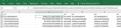

Good Evening,
The cells in file contains hexadecimal data. I have tried to format it into text. But it didn't work. I also tried HEX2DEC formula.
Please help me with this problem.

Did You take care formats?
Did You check that 'error'-note?
Could You send a sample file?
...without it - I could write that 'normal' file could work.

How could a sample file be too large to upload?
Do You have any image, what would be that (fd7c28f9fd8045f2) value be?

Hmmm, That excel version seems modern enough to have Power Query on board.
I tried with the one value in the picture that's absolutely clear
let
    Source = Excel.CurrentWorkbook(){[Name="Table1"]}[Content],
    #"Changed Type" = Table.TransformColumnTypes(Source,{{"some Hex", type text}}),
    #"Added Custom" = Table.AddColumn(#"Changed Type", "Custom", each Text.From(Expression.Evaluate("0x" & [some Hex])))
in
    #"Added Custom"
EDIT: added the example of Vletm. But I get other result.
Source: https://xxlbi.com/blog/converting-hexadecimal-to-decimal-numbers-in-power-query/
GraH - Guido
I didn't test it
... it seems to need some modifications.
Your non formula give better result.
Both below gives 18265519242872900000
=DECIMAL(B2,16)
=LET(L,LEN(B2),seq,SEQUENCE(L),SUM((FIND(MID(B2,seq,1),"0123456789ABCDEF")-1)*16^(L-seq)))
But ... Excel can show 15numbers and the rest are zeros.
