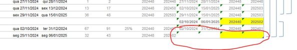

I need help with some formulas (those below) to calculate MIN/MAX in a range by section.
COL N=IF(G3="";MIN(G4:INDEX(G4:G$9941;MATCH(TRUE;INDEX(ISBLANK(G4:G$9941);0;1);0)));G3)
COL O=IF(H3="";MAX(H4:INDEX(H4:H$9941;MATCH(TRUE;INDEX(ISBLANK(H4:H$9941);0;1);0)));H3)
COL P=IFERROR(IF(A3<A4; MIN(INDIRECT("N" & ROW()+1 & ":N" & MATCH(A3; A4:A$9942;0)));L3);"")
COL Q=IFERROR(IF(A3<A4; MAX(INDIRECT("O" & ROW()+1 & ":O" & MATCH(A3; A4:A$9942;0)));M3);"")
They should calculate MIN/MAX sections in yellow cells. Some are calculated, some not.
The file attached shows my issue.
Thank you all in advance

Now I realize there are still some issues to solve (please see the cells in yellow) and I can't find the error

What is my expectation:
in cols N, O, P, Q formula should calculate MIN/MAX values from the cells below that match an higher level (col A).Otherwise, cell value is equal to value in cols G, H. L, M respectivally. The problem is in the MIN formula (cols N and P).
For Example:
N8 is level 2 (A8), next level 2 is N19 (A19), so N8 should display the MIN value from range N9:N18 (in this range, all levels are higher than 2)
N9 is level 3 (A9), next level 3 is N13 (A13), so N9 should display the MIN value from range N10:N12(in this range, all levels are higher than 3)
and so on...
This is not happening :(

In column R, please manually enter the results that you are expecting for all cells highlighted in yellow. I am not following your explanation, so still have no idea what they should be instead of what is being returned.

In col R, I´ve included a range scheme
In col S, there are MIN values (reporting to Col G) that should happen in Col N
  • Plan_Test.xlsx
