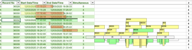

I continued testing ... with my own modified file.
If select eg Record No 38032,
it will show something like below based times:
Green - selected record
Black - overlapped
Yellow - other simultaneous records
Orange - overlaps within those 'yellow' records

Still testing ... my found MAX workload seems to be nine (9) ... max nine records in same time.
Which values someone is interesting ... simultaneous or 'workload'?
I found one view to see 'workload' per time - right side of below snapshot
Above part shows records per time - green is selected
Below part shows 'workload' - colors & height shows 'workload's ... there are nine (9) records same time in the end of 38032.
Left side shows that there are 13 simultaneous records with 38032.
Which one value (9 or 13) would match with Your needs?
Have You find out - what values do You really need to get?
I find one more possible value ... for 38332:
2 ... it tells that while 38332 starts it was second record which runs in same time
( 6 tells that 38332 has overlap with six other records,
2..3..4..5 tells that there were number of records same time (( below hours 15..19))
