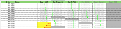

I changed file ...
Please check Sheet2?
You should see only ... absents (now yellows) ... if those are more important.
If You could see both, then it will be harder to notice - which belongs to which!
There are some data, which do not match with Your given ... ranges.
Question: how to handle cases if there are missing timestamps?
Your sample data has three timestamps which are out of time ranges (yellow with red arrows; gotta show like this).
... above snapshot shows that there are four more missing timestamps (grays) and whole Day 2 (PM)'s are missing or what?
Green lines shows ... moments of timestamps.
Note: Every time, the whole sheet will create again - except the 1st row.
