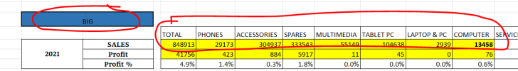

Answer Required Through Excel Formula in Sheet1 and Sheet2
Sheet 1"Summary Division" Colum B4 Drop Down Given
Sheet 2"Summary Branch" Colum B4 Drop Down Given
Sample Answer Give Yellow Higlighted
If Drop Down List Change Then Concerned Branch Or Division Sales And Profit Data Pick From Data Sheet as Prescribed Format
Data Sheet "Colum A" Mentioned Division Names
These are the Data Sheet

In Sheet -"Summary Division" & "Summary Branch" Sample Answer Given
Division Need to Pick from Data Sheet "Colum A"

Sample Answer In Summary "Branch Sheet" Which Where Picked from Data Sheet mentioned .

#10 Reply- Dear Sir
The data in the data sheet is taken from our software so it looks like a pivot table
kme
... then those sheets should have same layout - - there are differences.
You can use ... #12 sample ... with minor modification those differences.
