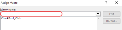

The trouble is that this same checkbox is located on other tabs in the workbook, and they're all linked.
It looks as if you've copied the checkbox (which you say is a Forms checkbox), or copied the sheet it's on, and so you've also copied the checkbox's assignment to the macro code.
You can remove that asignment by right-clicking the checkbox, choosing Assign Macro… and in the dialogue box that follows, delete what's in the Macro name: field and click OK.
