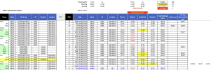

Dennie
I found few cases which needs to modify.
.. as well as I added some details, which You should have.
Below is the top of the latest layout.
Press [ Do It ] to refresh result.
  • FingerPrint Report.xlsb
