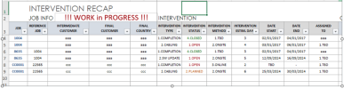

I try to put here an example of the sheet filled.
Thank you!!

The 4th sheet still horizontal but the "intervention" info are vertical.
There is no more 2nd or 3th "intervention" but only one column "intervention" and the 2nd or 3th should fill one below the other.
Like this:
A E columns are important for me to see the job informations.
Thank you so much!
