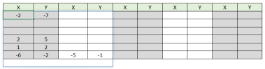

I have played some FILTER tricks to get a list of duplicates.
Worksheet function
= LISTDUPSλ(GridPointTbl[@])
where the Lambda function is defined by
LISTDUPSλ = LAMBDA(
    dataRow,
    LET(
        trimmed,   TOROW(dataRow, 1),
        wrapped,   WRAPCOLS(trimmed, 2),
        distinct,  UNIQUE(wrapped, 1, ),
        unique,    UNIQUE(wrapped, 1, 1), // otherwise all duplicates
        combined,  IFERROR(HSTACK(distinct, unique), distinct),
        duplicate, UNIQUE(combined, 1, 1), // otherwise no duplicates
        return,    IFERROR(duplicate, ""),
        TOROW(return,,1)
WRAPCOLS is used to pair up the x and y terms to make the use of UNIQUE possible. The variable 'distinct' holds a list of distinct (x, y) pairs whilst 'unique' is the list of pairs that are not duplicated. Stacking the two lists duplicates those pairs that were unique in the original, hence a further use of UNIQUE returns the original duplicates. Where things start to get painful is the fact that the required result is an array of arrays which, currently, is out of scope for the built-in helper functions.
Using a helper function BYROWλ that am developing gives
= BYROWλ(GridPointTbl, LISTDUPSλ)
  • Filter x,y duplicates A.xlsx

Building on what @Peter Bartholomew has already done, this in L3 copied down:
=LET(n, QUOTIENT(COUNTA(GridPointTbl[@]), 2),
k, SEQUENCE(n, 2),
list, INDEX(GridPointTbl[@], k),
distinct, UNIQUE(list),
unique, UNIQUE(list, , 1),
na, ROWS(distinct),
nb, ROWS(unique),
r, {1,1} * SEQUENCE(na + nb),
c, SIGN(r) * {1,2},
combined, IF(r <= na, INDEX(distinct, r, c), INDEX(unique, r - na, c)),
duplicate, IF(ISERROR(nb),distinct, UNIQUE(combined, , 1)),
x, IFERROR(duplicate, ""),
IFERROR(CHOOSE({1,2,3,4,5,6,7,8,9,10},INDEX(x,1,1),INDEX(x,1,2),INDEX(x,2,1),INDEX(x,2,2),INDEX(x,3,1),INDEX(x,3,2),INDEX(x,4,1),INDEX(x,4,2),INDEX(x,5,1),INDEX(x,5,2)),""))
Boy, it's clunky, but it seems to work!

Sorry for the very late reply. I needed to back off from Excel formulas. I was completely burned out. I would very much just like to utilize the FILTER formula because I can understand it better than not using a FILTER formula at all. I have to use it on other parts of the worksheet that uses 200 columns and 10 rows. And that's just one table of an array out of 20 to 30 arrays. So that's why I just sent a short version ( Oct 14, 2024 - #1 post of this forum) so it would be easier to do but found out that the formulas that excel helpers wrote didn't work accordingly to plan.
Try either of the following in cell L2:
=LET(
    f, FILTER(A2:J2,A2:J2<>""),
    s, SEQUENCE(COLUMNS(f)/2,2),
    v, INDEX(f,,s),
    x, INDEX(v,,1),
    y, INDEX(v,,2),
    u, UNIQUE(FILTER(v,MMULT((x=TRANSPOSE(x))*(y=TRANSPOSE(y)),IF({1},1,x))>1,"")),
    n, SEQUENCE(COUNTA(u),,0),
    TRANSPOSE(INDEX(u,INT(n/2)+1,MOD(n,2)+1))
Or:
=LET(
    v, INDEX(f,,s),
    a, UNIQUE(v),
    b, UNIQUE(v,,1),
    u, FILTER(a,ISERROR(XMATCH(INDEX(a,,1)&"|"&INDEX(a,,2),INDEX(b,,1)&"|"&INDEX(b,,2))),""),
See attached...
  • Filter x,y duplicates B.xlsx
Thank you so much. However, I now have the formula to display both duplicates AND non-duplicates. And I have provided the formula to display duplicates only. I used both formulas which you sent/created and I test it and it works great and both formulas worked the same to display duplicates only. But I do not have the formula to display non-duplicates only. Would you please be so kind as to show me how I can revised the formula to do that? Thank you!
