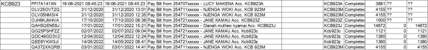

formula in column B returns ??
KCB923M
but when omitting the last digit, the result is quite satisfactory :-
A formula is placed on B1
the formula used is =IFERROR(VSTACK(FILTER('1stfebtill31stdec2021'!$A$2:$G$134137,ISNUMBER(SEARCH($A1,'1stfebtill31stdec2021'!$E$2:$E$134137))),FILTER('1stjantill31stdec2020'!$A$2:$G$84468,ISNUMBER(SEARCH($A1,'1stjantill31stdec2020'!$E$2:$E$84468))),FILTER('1stjantill31stdec2022'!$A$2:$I$213575,ISNUMBER(SEARCH($A1, '1stjantill31stdec2022'!$E$2:$E$213575)))),"??")
how can i obtain exact match ? :rolleyes:

KCB923M??????????????????
OLV25OVT2Q
31/12/2020​
31/12/2020 13:01​
Pay Bill from 254711xxxxxx - NJENGA WOKI Acc. KCB 923MKCB923MCompleted
4155​
OLV05NMSI4
31/12/2020​
31/12/2020 12:35​
4155​
QA372XXQRB
03/01/2022​
03/01/2022 14:41​
4155​
0​
4155​
