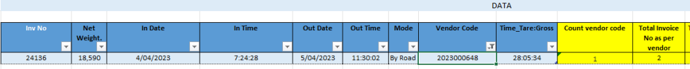

I have a data range B5:J24, as per my requirement I have solved by formula.
But, I want in by power query?
Is it possible my requirement which I get by formula is solved by power query?
If yes, then please guide how to do.
Example data is attached for your kind information.

Hi @sambit
I'm a bit confused by your formulas. In the example below, I've filtered on a a single vendor code and there is only 1 invoice number. So what's the logic behind the Total Invoice No as per vendor? It says 2. Why?
And I do not see the need for repeating the value column Time_Care: Gross.
This Power Query does already what you need, except the counter I do not get.

sir,
2 Nos of vendor code against invoice no - 24136.
if you filter invoice no - 24136, then you get 2 nos of vendor code i.e, 2023000648 & 2023000923
So it's the number of vendors per order number.
Thanks for clarifying.
I might have a look later today still.
You can add a second grouping, like below.
