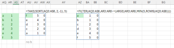

=FILTER(AQ3:AS20,AR3:AR20>=LARGE(AR3:AR20,5))
Try:
=FILTER(AQ3:AS6,AR3:AR6>=LARGE(AR3:AR6,MIN(5,ROWS(AQ3:AS6))))
or to reduce the number of times you need to refer to ranges:
=LET(a,AQ3:AS6,b,AR3:AR6,FILTER(a,b>=LARGE(b,MIN(5,ROWS(a)))))
or to refer to just one range, maybe:
=LET(a,AQ3:AS6,b,CHOOSECOLS(a,2),FILTER(a,b>=LARGE(b,MIN(5,ROWS(a)))))
Another function that is also applicable would be TAKE, applied to a sorted dataset.
= TAKE(SORT(range, 2,-1), 5)
where 'range' represents the name you have defined to apply to your dataset.
I haven't tested but wouldn't TAKE give a different result if there were ties in the top 5 (and there were more then 5 rows in the source)?
SORT ranks ties in the order in which they arise and TAKE treats them as separate entities. Usually that gives the desired result but, if not, I am sure additional rules can be accommodated.

The range ChartData2 is not dynamic so the Total column contains blanks, which messes up the SORT (blanks tend to come last, but you want the sort order reversed). Some additional filtering would provide one solution to the problems
= LET(
    totals, CHOOSECOLS(ChartData2, 2),
    data,   FILTER(ChartData2, totals<>""),
    TAKE(SORT(data, 2, -1), 5)
