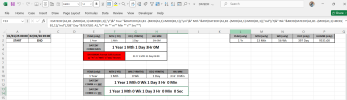

Please see attached Spreadsheet & Screen-Shot for clarification, what I'm asking for, which in a Spreadsheet is far more obvious then Words in Black&White etc.
1. DATES SUBTRACTED, but is incorrect with current FORMULA & FORMAT CELLS, yes I did try BRACKETS on HOURS… [HH] but was not right…either..!
FORMAT CELLS CUSTOM:
yy "Yr" m "Mth" d "Day" hh:mm
See CELL E5 in RED for ERROR, & compare with correct DATE+TIME calc in F3.
=B1-A1
