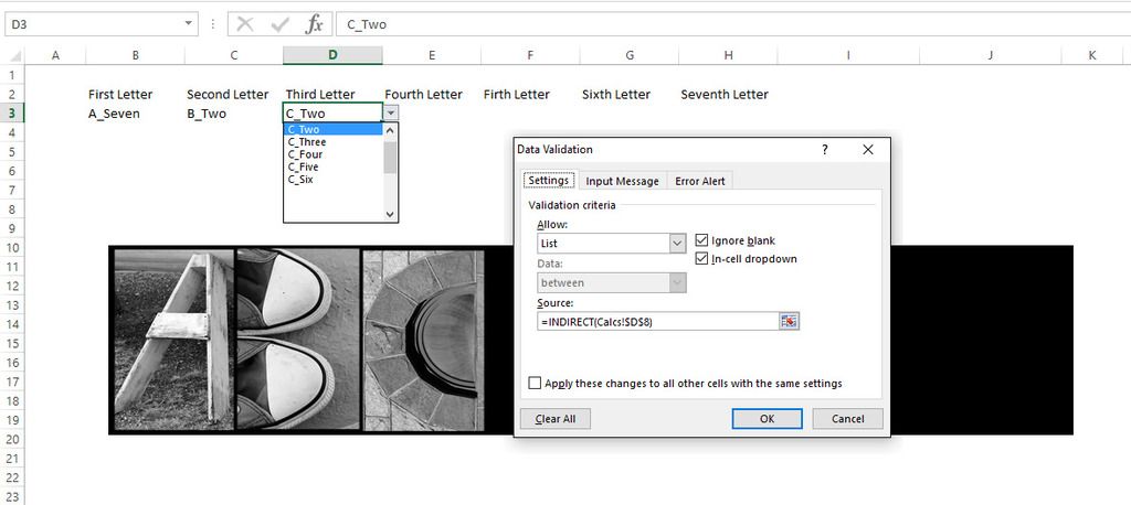

Hello ALL!
I'm using =INDIRECT(Calcs!$D$8) as my list source for a Data Validation | List cell.
That indirect calls a Named Array with 4-11 selections in it.
The Data Validation Letter Change as the client enters their name...
I would like to Auto Populate the Data Validated field with the 1st available item in the named Range.
Respectfully,
Paul F
Chihiro, that would explain why my search yielded - nada...
I'm a golf ball in tall grass when it comes to Excel VBA... Lost :-(
Anyone have a little code handy ??

There are codes out there. But it will have issue with Named Lists populated with formula. As there is no direct way to get at populated values.
For formula populated Named Range, if you look in Named Range you should see {...} as value. Where as if it is defined range you should see {"Test1"; "Text2";...}.
It may be easier to use ActiveX combobox. See link below, how to layer Combobox over data validation.
http://www.contextures.com/xlDataVal10.html
You can then easily select any item in the list using "Combobox.ListIndex = x" where x is the number.
