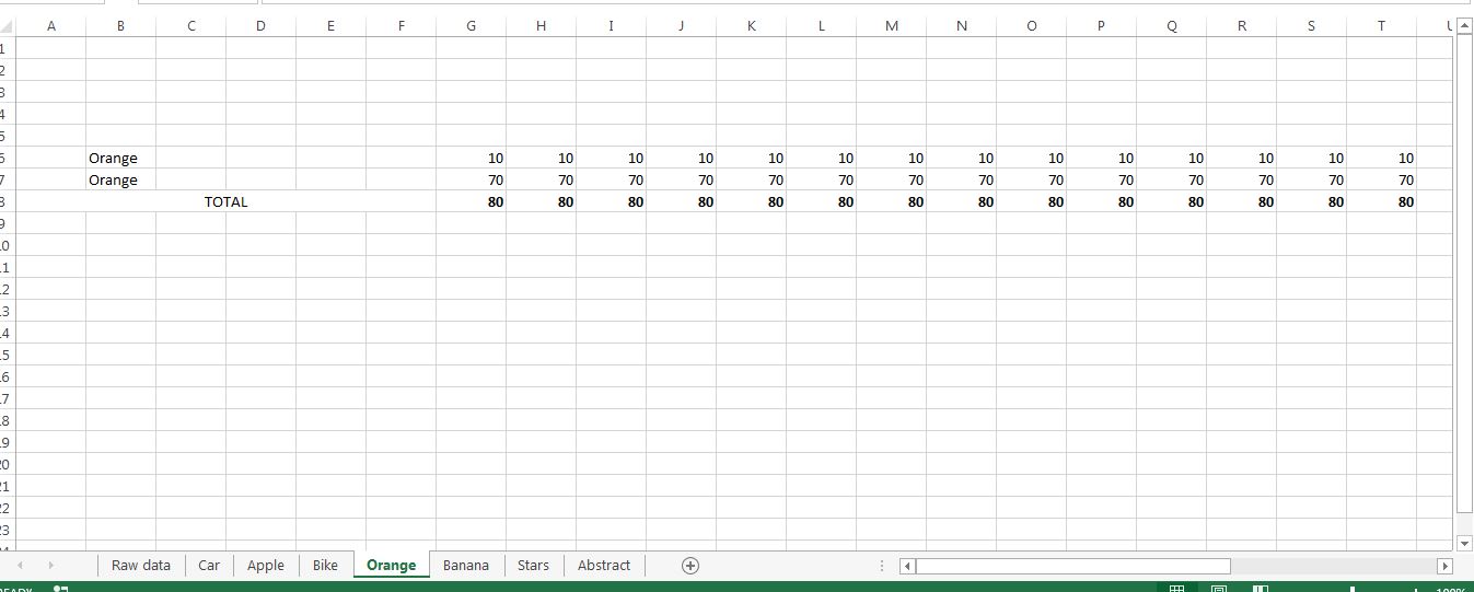

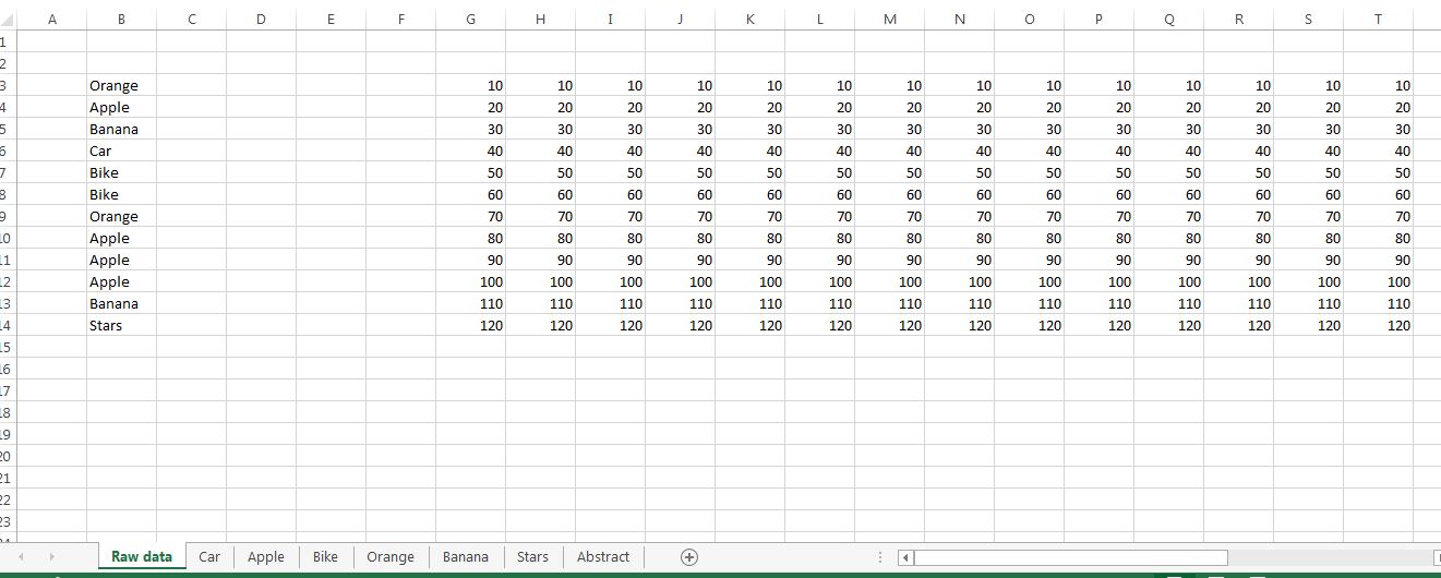

I have 100+ sheets in excel & the main data sheet is named as "raw data". I have to copy rows from "raw data" sheet to every sheet if the text of Column B matches with the sheet name.

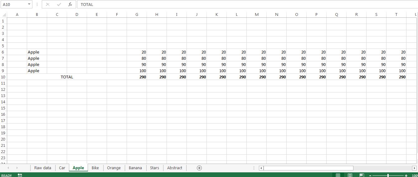

I am using the above code to copy the data from Raw Data sheet to different sheet from G to AG row starting from pasting the data B6 onward in respective sheet. With the above code I am getting the sum of all the sheets below the data.
I need some more tweaks in the code
1. I want a merged Text "TOTAL" in A to F column in each sheet.

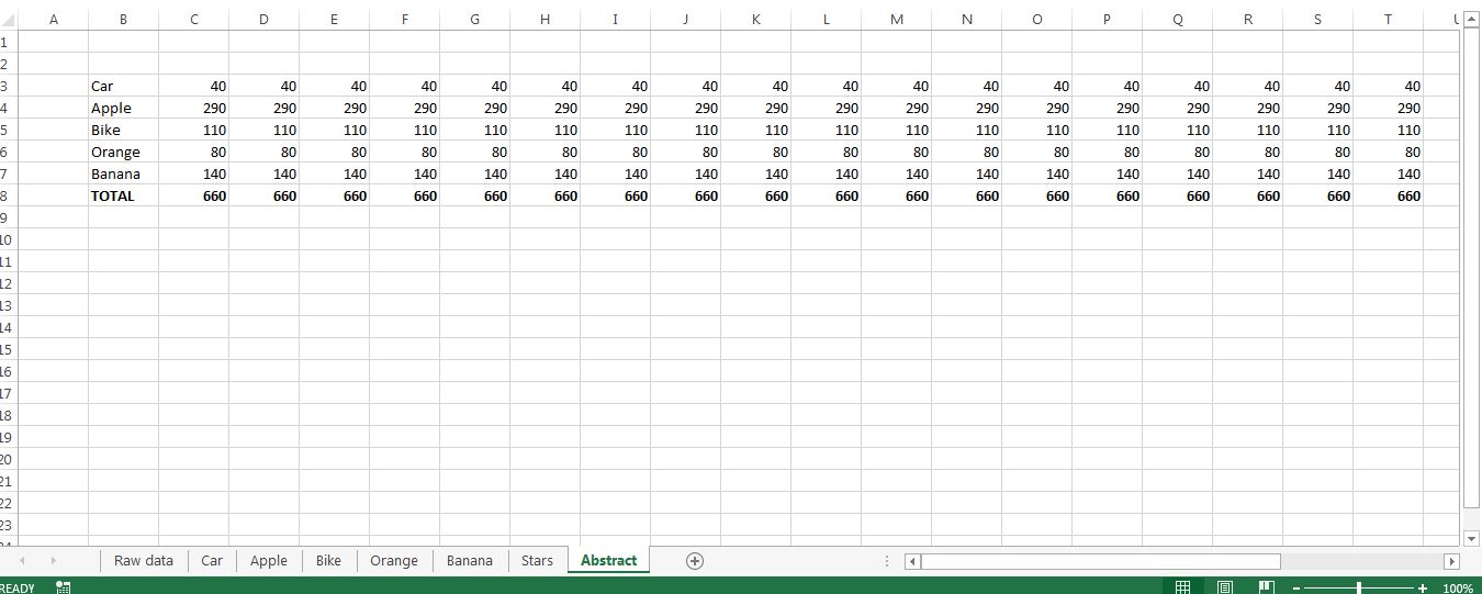

2. I have an another sheet named "Abstract" where I want to automatically link the TOTAL of each sheet on C onward.
For example in the Abstract sheet, those sheets TOTAL will be linked which Sheet names are there in the Sheet.
For example as per the picture uploaded I have a sheet named Stars but as the name Star is not present in the Abstract sheet that sheet total is not required to be linked.
And again a TOTAL of the abstract sheet is required.
What should be the change in the code required ? kindly check the images to understand better.
