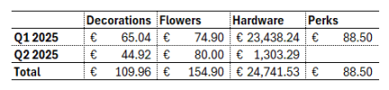

Yes, a pivot table.
That pivot table could be in own sheet too.
Your data could be like as in my sample sheet without any 'monthly calculations'.

This requires an up to date version of 365.
= PIVOTBY(yearQuarter, tag, amount, SUM,,,,0)
