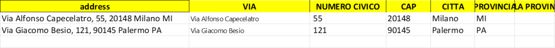

Can you help me break down the addresses in a column.
I have already inserted two formulas that work, the others don't work.
to search for the postcode it would be enough to find the string made up of 5 digits without spaces with a subsequent and preceding space.
There are commas that separate the data type but it is also true that they are not always found in the same arrangement so I wonder how one would be able to manage the various cases?
Thank you

Try in B2 copied down (requires Excel 365):
=HSTACK(TEXTSPLIT(TEXTBEFORE(A2,",",2),","),TEXTSPLIT(TEXTAFTER(A2,", ",2)," "))

The formulas in the blue cells were already working.
I can't create the orange cell formulas to extract the data you see.

This is a copy of your file containing @AliGW 's formula. Your version of Excel should translate the formulas. If it doesn't it means you are not using Excel 365.
