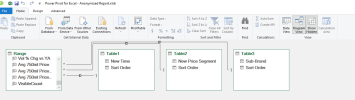

My relationships are set up to facilitate a custom sort order for a few of my slicers, so I linked them from many to one instead of one to many. Is that a "no-no"? If I did it the other way around, I believe the functionality I'm looking for wouldn't work. Is that why this seems to break down on the table where each row is at product level instead of aggregated under a different Pivot field?
If you follow the link to my post on myonlinetraininghub.com, you can download an anonymized version of my data to take a look at the relationships. Here's a snap:

Linking many to one is the same as vice versa so I’m not really sure what you mean, or what sort order has to do with relationships. I will just note for now that filtering only goes from one to many, not the other way.

Just to give you some background context:
I have a slicer for Time, a slicer for Price Segment (New Price Segment), and a slicer for Sub-Brand. The slicer orders the items in these fields alphabetically by default, but I don't want that. I also don't want to add a "helper digit" at the front of each item to force the slicer to sort the way I want. Hence, the connected tables.
Since the connected tables have the fields and sort order I want to filter by, I set up the relationships from many to one.
This works for every other Pivot Field I place in "rows" but always seems to break down at the item level (or when I put the product in the rows).
As I said, the filtering only works in the direction of 1 to many. If you apply a slicer that affects the Range table, that filtering will not affect any other tables on the 1 side of the relationships to that table. Hence, if you filter Supplier, for example, which is connected to the Range table, it will not affect any slicers based on Table1, Table2 or Table3.
If you want that to happen, you could add the sort orders as calculated columns in the Range table - either using RELATED in the data model, or in Power Query.
