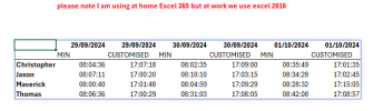

Dear experts​
I would greatly appreciate any assistance on this issue​
I am trying to pull out the first timestamp attempt In And Out From Column C​
First Criteria Date​
Second Criteria Name​
Any assistance is greatly appreciated​
Best Regards​
please note I am using it at home Excel 365 but at work, we use Excel 2016​

Here one sample 'between' Your please note.
Sir first of all thank you for your time and your suggested solution​
I tried this formula in Cell H5 "In" without adding 3 Hour 3:00:00​
=INDEX($E$4:$E$75, MATCH(SMALL(IF(($B$4:$B$75=$G5) * ($D$4:$D$75=$H$3), $E$4:$E$75, ""), 1), IF(($B$4:$B$75=$G5) * ($D$4:$D$75=$H$3), $E$4:$E$75, ""), 0), COLUMN(A1))​
the result was perfect same as yours but without adding 3 Hours​
I tried to modify the formula in Cell I5 "Out" but I failed​
=INDEX($E$4:$E$75, MATCH(SMALL(IF(($B$4:$B$75=$G5) * (TEXT($E$4:$E$75, "hh:mm")="17:00") * ($D$4:$D$75=$H$3), ROW($E$4:$E$75)-ROW($E$4)+1, ""), 1), ROW($E$4:$E$75)-ROW($E$4)+1, 0), COLUMN(A1))​
any suggestion to correct my formula will be highly appreciated​
