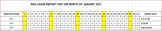

Here one sample based Your picture:
A-column has those absent dates - You name one, but normally there are many of those.
AL-column has the 'result'.
You can see a sample code right side.
As written in previous post ... it could be smoother for You to post a sample file.
Hello, according to the initial post picture assuming 'EMPLOYEE NAME' is in cell A3 a formula VBA demonstration for starters :​
