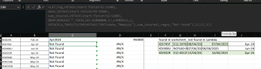

regretful it does not return the desired result, see screenshot.

on a brighter note, it returned results of 15 regno with your lambda

I can't troubleshoot a workbook I have no access to. I can't troubleshoot from screenshots. Where it returns "Not Found", there is no match. Provide a workbook with that error and I'll see if I can tell you why, but if there is no exact match, then it's your data that isn't consistent.
As I showed, it works in the sample workbook you provided.
am only using your workbook attachment given by you,no other,placing real data for the company, using Ctrl F to see in reality if the data exist against the results you give (it does but your result says not found), , then instead of 2000 lines, i decided to try with 30 lines,
