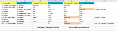

I would appreciate, if you make correction in below highlighted 2 conditions;
1. As the keyword "GYM" is not listed in the classification, but last cell in BR column, the output is "LIQ" only which is incorrect. This must be "LIQ+STOP". [However, if product code is only "MH76GYML" without "+" then result output is correct i.e. "STOP", but not working with dual products]
2. The third product code in column X is "MH35SOLT+KQ71GASL", but results with your function is "GAS+SOL". However, the correct results should be "SOL+GAS", must be in sequence.
I hope I able to explain you.
I will be thanksful if you resolve my this issue as well.
