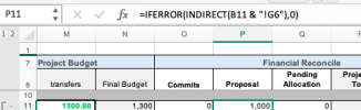

Could You modify Yourself my green formula as You really would like to use?
... eg to ...hmm? to Contract Budget's cell P11 =INDIRECT(B11 & "!G6")
The above returned #REF with an invalid cell reference. so, I tried =INDIRECT(B12,'1.01'!G6), same error.
My attempt to write out your green formula below:
=INDIRECT(Reference Sheet Name which is derived from B11)('1.01'!D13) but that '1.01' Sheet in the return value should be determined by the indirect reference to column B...
Thanks again!
I ( mpyrant ) tried =INDIRECT(B12,'1.01'!G6), same error.​
... but I offered in cell M11 as below
... and to cell P11 as below (if You would like to avoid some errors)
Can You see differences?
VLETM - one more question. Instead of returning #REF when there is no value in the specified cell, can I add to the formula "If False,0" so it shows Zero dollars instead of an error?
I had tried to add the ,0 into the formula but it didn't read correctly. Are you saying I should incorporate, "
=INDIRECT(B12,'1.01'!G6),IFERROR(0)​
