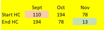

I have a data consisting of HC being monitored on a weekly basis;
seeking your assistance so that I could get the current month's running week's ending HC.
example for September: Starting HC is the ending HC from August and ending HC is the 4th week of September WB0924
for October: Starting HC is the ending HC from September (194) and ending HC is the 5th week of October WB1029
while for November: Starting HC is the ending HC from October (78) and running week's HC WB1112 (13)
Please see attached file

I can get you the figures you need, but not in the arrangement that you want.
In the attached, changed and added (simple) formulae in columns A, B & C.
At cell I10 a pivot table giving you data for your first table.
At cell P10 a pivot giving you your end of month/running week's HC. The Max of Week column in that pivot is only so that I can filter the results for the final week in each month (see filter for the WB field), you can ignore/hide that column.
