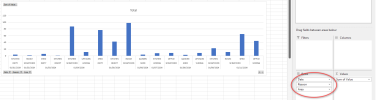

If Your datas layout is as You've given then outputs could be something like below:

In the attached, Pivot table and chart after transforming data with Power Query. You can adjust how the x-axis appears by dragging the Date/Reason/Area to a different order within the Rows section of the Pivot table & Chart:
See attached workbook.

Yes, there is around 50 reasons, and they are added at the end of the month. I need the chart to be for a year but data to show only for the months I have data. I have added a random number, for example, attached as I was not sure how to show what I meant. What I wanted to create is as you did in the first chart is everything by month and in each month I wanted to have each area (where there is a data above 0) and in each area the reason (if there is data above 0), My biggest problem was to create a graph without showing data where the value is 0
Thank you. I work with what you sent, and this is exactly what I wanted. I just need to make power query work in my workplace. thank you :)
