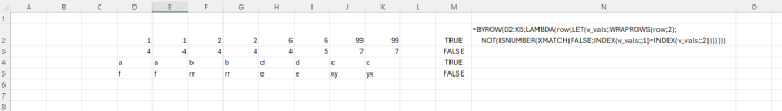

If you have Excel 365, this formula is one possibility.
=BYROW(D2:K5;LAMBDA(row;LET(v_vals;WRAPROWS(row;2);
     NOT(ISNUMBER(XMATCH(FALSE;INDEX(v_vals;;1)=INDEX(v_vals;;2)))))))
Notice I'm on EU style, so where I have ";", you might have ",".

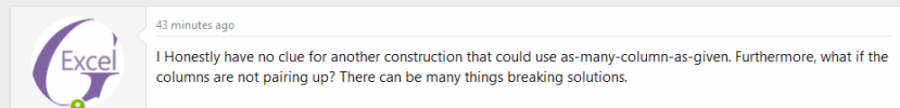

Very nice addition by @p45cal .
From a private conversation on the topic... ;-)
