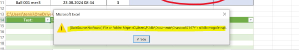

I try to test excel file you send me and it says me incorect path file? I change the path with my path file and I click refresh and I didnt get any data?

Be absolutely sure that the path is correct, with no leading/trailing spaces and no final slash character. Copy/Paste that folder path from somewhere if you can.
If you still can't make it work, could you quote the actual path here?

your path: C:\Users\Public\Documents\Chandoo57767
my path: C:\Users\tenis\OneDrive\Dokumenti\ElenaGlavniDokumenti\UrejanjePodatkov\002
That error dialogue shouldn't be trying to look at …\Chandoo57767… it should be looking at what's in cell A13 via cell A13 being a named range in Name Manager called Path. Have you changed something there?
Attach you failing file here so I can check for changes?

Ohhh
I think know what is wrong.
I put your excel file in the same folder with my csv files.
Now I put the excel file in another folderr and I get dataaaaaaaa.
oohhhh it seems is working....
