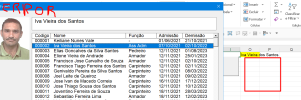

Hi, there a way to change the image on userform when i select another name in listbox?
I have a shape that change on the worksheet when i select a name in listbox, but on Userform only change when i initialize.
Here the code on the project:

Hi, i have a upgrade of the project.
But, the thing is there is a way to remove the borders in Image Control?
The picture lost some quality(Frames), there is a way to fix that?
The keyboard Up and Down stop working.
On VBE side via the BorderStyle in the image Properties window (F4) in the Userform …​
The easy direct way is to load directly the picture from the original on disk as Excel was designed for …​
Or at least the original picture must be imported in Excel with the worksheet at 100% zoom​
with the cell as large as the original picture on disk which should be also as large as the picture object in the UserForm.​
When the picture is not well imported within the worksheet like in your attachment​
so in order to lose less quality - but still lose some, will be less than loading directly from the original on disk -​
before to export the temp chart image on disk is to resize the chart object at the size of the Userform image at least …​
